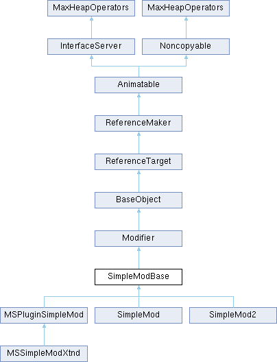

SimpleModBase Class Referenceabstract
Base class for object space modifiers. More...
#include <C:/adskgit/3dsmax/3dsmax/3dswin/src/maxsdk/include/simpmod.h>
Inheritance diagram for SimpleModBase:

virtual int GetKeySelState (BitArray &sel, Interval range, DWORD flags)
CoreExport void OpenTreeEntry (int type, DWORD tv)
CoreExport void CloseTreeEntry (int type, DWORD tv)
CoreExport int IsTreeEntryOpen (int type, DWORD tv)
CoreExport BOOL GetSelInTrackView (DWORD tv)
CoreExport void SetSelInTrackView (DWORD tv, BOOL sel)
CoreExport BOOL InTrackViewSelSet (int which)
CoreExport void SetTrackViewSelSet (int which, BOOL inOut)
virtual BOOL CanAssignController (int subAnim)
 Return true if we can reassign the subanim specified.
virtual BOOL CanMakeUnique ()
CoreExport int EnumAnimTree (AnimEnum *animEnum, Animatable *client, int subNum)
virtual int RenderBegin (TimeValue t, ULONG flags=0)
virtual int RenderEnd (TimeValue t)
virtual CoreExport Interval GetTimeRange (DWORD flags)
virtual void EditTimeRange (Interval range, DWORD flags)
virtual void DeleteTime (Interval iv, DWORD flags)
virtual void ReverseTime (Interval iv, DWORD flags)
virtual void ScaleTime (Interval iv, float s)
virtual void InsertTime (TimeValue ins, TimeValue amount)
virtual BOOL SupportTimeOperations ()
virtual CoreExport void MapKeys (TimeMap *map, DWORD flags)
virtual void DeleteKeys (DWORD flags)
virtual void DeleteKeyByIndex (int index)
virtual void SelectKeys (TrackHitTab &sel, DWORD flags)
virtual void SelectSubKeys (int subNum, TrackHitTab &sel, DWORD flags)
virtual void SelectSubCurve (int subNum, BOOL sel)
virtual void SelectKeyByIndex (int i, BOOL sel)
virtual BOOL IsKeySelected (int i)
virtual void FlagKey (TrackHitRecord hit)
virtual int GetFlagKeyIndex ()
virtual int NumSelKeys ()
virtual void CloneSelectedKeys (BOOL offset=FALSE)
virtual void AddNewKey (TimeValue t, DWORD flags)
virtual void MoveKeys (ParamDimensionBase *dim, float delta, DWORD flags)
virtual void ScaleKeyValues (ParamDimensionBase *dim, float origin, float scale, DWORD flags)
virtual void SelectCurve (BOOL sel)
virtual BOOL IsCurveSelected ()
 Returns TRUE if the function curve is selected; otherwise returns FALSE.
virtual BOOL IsSubCurveSelected (int subNum)
 Returns the selected state of the sub-curve whose index is passed.
virtual int GetSelKeyCoords (TimeValue &t, float &val, DWORD flags)
virtual void SetSelKeyCoords (TimeValue t, float val, DWORD flags)
virtual int SetSelKeyCoordsExpr (ParamDimension *dim, const MCHAR *timeExpr, const MCHAR *valExpr, DWORD flags)
virtual void AdjustTangents (TrackHitRecord hit, ParamDimensionBase *dim, Rect &rcGraph, float tzoom, int tscroll, float vzoom, int vscroll, int dx, int dy, DWORD flags)
virtual void AdjustTangents (TrackHitRecord hit, ParamDimensionBase *dim, float angle, float length, DWORD flags)
virtual CoreExport BOOL IsAnimated ()
virtual BOOL CanCopyTrack (Interval iv, DWORD flags)
virtual BOOL CanPasteTrack (TrackClipObject *cobj, Interval iv, DWORD flags)
virtual TrackClipObject * CopyTrack (Interval iv, DWORD flags)
virtual void PasteTrack (TrackClipObject *cobj, Interval iv, DWORD flags)
virtual BOOL CanCopySubTrack (int subNum, Interval iv, DWORD flags)
virtual BOOL CanPasteSubTrack (int subNum, TrackClipObject *cobj, Interval iv, DWORD flags)
virtual TrackClipObject * CopySubTrack (int subNum, Interval iv, DWORD flags)
virtual void PasteSubTrack (int subNum, TrackClipObject *cobj, Interval iv, DWORD flags)
virtual int GetTrackVSpace (int lineHeight)
virtual int HitTestTrack (TrackHitTab &hits, Rect &rcHit, Rect &rcTrack, float zoom, int scroll, DWORD flags)
virtual int PaintTrack (ParamDimensionBase *dim, HDC hdc, Rect &rcTrack, Rect &rcPaint, float zoom, int scroll, DWORD flags)
virtual int PaintSubTrack (int subNum, ParamDimensionBase *dim, HDC hdc, Rect &rcTrack, Rect &rcPaint, float zoom, int scroll, DWORD flags)
virtual int PaintFCurves (ParamDimensionBase *dim, HDC hdc, Rect &rcGraph, Rect &rcPaint, float tzoom, int tscroll, float vzoom, int vscroll, DWORD flags)
virtual int HitTestFCurves (ParamDimensionBase *dim, TrackHitTab &hits, Rect &rcHit, Rect &rcGraph, float tzoom, int tscroll, float vzoom, int vscroll, DWORD flags)
virtual int PaintSubFCurves (int subNum, ParamDimensionBase *dim, HDC hdc, Rect &rcGraph, Rect &rcPaint, float tzoom, int tscroll, float vzoom, int vscroll, DWORD flags)
virtual int HitTestSubFCurves (int subNum, ParamDimensionBase *dim, TrackHitTab &hits, Rect &rcHit, Rect &rcGraph, float tzoom, int tscroll, float vzoom, int vscroll, DWORD flags)
virtual void EditTrackParams (TimeValue t, ParamDimensionBase *dim, const MCHAR *pname, HWND hParent, IObjParam *ip, DWORD flags)
virtual int TrackParamsType ()
virtual int GetFCurveExtents (ParamDimensionBase *dim, float &min, float &max, DWORD flags)
 This method is called to calculate the largest and smallest values of the anim.
CoreExport void AddNoteTrack (NoteTrack *note)
CoreExport void DeleteNoteTrack (NoteTrack *note, BOOL delNote=TRUE)
CoreExport BOOL HasNoteTracks ()
CoreExport int NumNoteTracks ()
CoreExport NoteTrack * GetNoteTrack (int i)
CoreExport DWORD DeleteAllNoteTracks ()
virtual void FreeAllBitmaps ()
virtual void GetSystemNodes (INodeTab &nodes, SysNodeContext Context)
virtual BOOL IsSubClassOf (Class_ID classID)
 returns true if the animatable has sub-classed off the given class
virtual CoreExport void MouseCycleCompleted (TimeValue t)
virtual CoreExport void MouseCycleStarted (TimeValue t)
virtual int NumParamBlocks ()
virtual IParamBlock2 * GetParamBlockByID (short id)
CoreExport bool SvSaveData (ISave *isave, USHORT id)
CoreExport bool SvLoadData (ILoad *iLoad)
CoreExport DWORD SvGetRefIndex ()
CoreExport void SvSetRefIndex (DWORD i)
CoreExport bool SvDeleteRefIndex ()
CoreExport SvGraphNodeReference SvStdTraverseAnimGraph (IGraphObjectManager *gom, Animatable *owner, int id, DWORD flags)
virtual CoreExport bool SvIsHighlighted (IGraphObjectManager *gom, IGraphNode *gNode)
virtual CoreExport COLORREF SvGetSwatchColor (IGraphObjectManager *gom, IGraphNode *gNode)
virtual CoreExport bool SvIsInactive (IGraphObjectManager *gom, IGraphNode *gNode)
virtual CoreExport bool SvEditProperties (IGraphObjectManager *gom, IGraphNode *gNode)
virtual CoreExport MSTR SvGetTip (IGraphObjectManager *gom, IGraphNode *gNode)
virtual CoreExport MSTR SvGetRefTip (IGraphObjectManager *gom, IGraphNode *gNode, IGraphNode *gNodeMaker)
virtual CoreExport bool SvCanDetach (IGraphObjectManager *gom, IGraphNode *gNode)
virtual CoreExport bool SvDetach (IGraphObjectManager *gom, IGraphNode *gNode)
virtual CoreExport MSTR SvGetRelTip (IGraphObjectManager *gom, IGraphNode *gNodeTarget, int id, IGraphNode *gNodeMaker)
 Returns a string to be displayed in the tip window in the schematic view for a relationship from "gNodeMaker" to "gNodeTarget"...
virtual CoreExport bool SvCanDetachRel (IGraphObjectManager *gom, IGraphNode *gNodeTarget, int id, IGraphNode *gNodeMaker)
 Returns true if this object can respond to the SvDetachRel(...) method...
virtual CoreExport bool SvDetachRel (IGraphObjectManager *gom, IGraphNode *gNodeTarget, int id, IGraphNode *gNodeMaker)
 Detach this relationship.
virtual CoreExport bool SvHandleRelDoubleClick (IGraphObjectManager *gom, IGraphNode *gNodeTarget, int id, IGraphNode *gNodeMaker)
 Called when this relationship is double-clicked in the schematic view...
CoreExport ICustAttribContainer * GetCustAttribContainer ()
 This method returns a pointer to the custom attributes container interface class.
CoreExport void AllocCustAttribContainer ()
 This method allocates space for a custom attributes container.
CoreExport void DeleteCustAttribContainer ()
 This method deletes space used by a custom attributes container.
void SetAFlag (DWORD mask)
void ClearAFlag (DWORD mask)
 Clears one or more bits in the Animatable flags.
bool TestAFlag (DWORD mask) const
 Tests one or more bits in the Animatable flags.
void SetAFlagEx (DWORD mask)
 Sets one or more bits in the Animatable extended flags.
void ClearAFlagEx (DWORD mask)
 Clears one or more bits in the Animatable extended flags.
bool TestAFlagEx (DWORD mask) const
 Tests one or more bits in the Animatable extended flags.
CoreExport bool TestFlagBit (int index)
 Tests the specified flag bit.
CoreExport void SetFlagBit (int index, bool newValue=true)
 Sets the specified flag bit.
CoreExport void ClearFlagBit (int index)
 Clears the specified flag bit.
Public Member Functions inherited from InterfaceServer
virtual UtilExport ~InterfaceServer ()
 Destructor.
template<class InterfaceType>
InterfaceType * GetTypedInterface ()
Public Attributes
Control * tmControl
Control * posControl
Static Public Attributes
static CoreExport IObjParam * ip
static MoveModBoxCMode * moveMode
static RotateModBoxCMode * rotMode
static UScaleModBoxCMode * uscaleMode
static NUScaleModBoxCMode * nuscaleMode
static SquashModBoxCMode * squashMode
static SimpleModBase * editMod
Static Public Attributes inherited from Animatable
static const AnimHandle kInvalidAnimHandle = 0
Protected Member Functions
virtual CoreExport ~SimpleModBase ()
 Destructor. This is a base class that is not meant to be instantiated directly.
virtual CoreExport void SetReference (int i, RefTargetHandle rtarg) override
 Stores a ReferenceTarget as its 'i-th' reference`.
Protected Member Functions inherited from ReferenceTarget
CoreExport int DoEnumDependentsImpl (DependentEnumProc *dep) override
 Method to perform an enumeration on a ReferenceTarget.
virtual CoreExport ~ReferenceTarget ()=0
 Destructor.
Protected Member Functions inherited from ReferenceMaker
virtual CoreExport ~ReferenceMaker ()=0
 Destructor.
void BlockEval ()
 Validates a given reference link between this reference maker and its reference target.
void UnblockEval ()
int Evaluating ()
CoreExport RefResult StdNotifyRefChanged (const Interval &changeInt, RefTargetHandle hTarget, PartID partID, RefMessage message, BOOL propagate, NotifyDependentsOption notifyDependentsOption)
Protected Member Functions inherited from Animatable
virtual CoreExport ~Animatable ()=0
 Destructor.
Protected Member Functions inherited from Noncopyable
 Noncopyable ()
 ~Noncopyable ()
Additional Inherited Members
Static Public Member Functions inherited from Modifier
static CoreExport bool GetInputType (ClassDesc *cd, Class_ID &inputType)
 To determine the input type of a modifier, an instance of the modifier needs to be created.
Static Public Member Functions inherited from Animatable
static CoreExport BOOL IsDeleted (Animatable *anim)
 Debug method to determine whether an object has been deleted.
static CoreExport AnimHandle GetHandleByAnim (Animatable *anim)
 Get the unique handle for an Animatable object.
static CoreExport Animatable * GetAnimByHandle (AnimHandle handle)
 Get an Animatable object from its unique handle.
static CoreExport AnimHandle GetNextHandle ()
 Get the unique handle for the next Animatable object to be created.
static CoreExport DWORD GetNumAnimatables ()
 Get the number of existing Animatable objects.
static CoreExport Tab< AnimHandle > GetExistingAnimatables ()
 Get a list of existing Animatable objects.
static CoreExport void EnumerateAllAnimatables (EnumAnimList &enumProcObject)
 Enumerator to enumerate across all animatables.
static CoreExport bool RegisterAppDataLoadCallback (const Class_ID &cid, SClass_ID sid, APPDATALOADPROC proc)
 Registers a callback proc that is called when an AppDataChunk is read from a scene file.
static CoreExport bool UnRegisterAppDataLoadCallback (const Class_ID &cid, SClass_ID sid, APPDATALOADPROC proc)
 Unregisters a callback proc that is called when an AppDataChunk is read from a scene file.
static CoreExport bool RegisterAppDataLoadCallback (DWORD sbid, APPDATALOADPROC proc)
static CoreExport bool UnRegisterAppDataLoadCallback (DWORD sbid, APPDATALOADPROC proc)
static CoreExport void ClearAFlagInAllAnimatables (DWORD mask)
 Clears one or more bits in the Animatable flags in all Animatables.
static CoreExport void ClearAFlagExInAllAnimatables (DWORD mask)
 Clears one or more bits in the Animatable extended flags in all Animatables.
static CoreExport int RequestFlagBit ()
 Requests an unique flag bit index.
static CoreExport void ReleaseFlagBit (int index)
 Releases the flag bit index.
static CoreExport void ClearFlagBitInAllAnimatables (int index)
 Clears the specified flag bit in all Animatables.
Static Public Member Functions inherited from MaxHeapOperators
static UtilExport void * operator new (size_t size)
 Standard new operator used to allocate objects If there is insufficient memory, an exception will be thrown.
static UtilExport void * operator new (size_t size, const std::nothrow_t &e)
 Standard new operator used to allocate objects if there is insufficient memory, NULL will be returned.
static UtilExport void * operator new (size_t size, const char *filename, int line)
 New operator used to allocate objects that takes the filename and line number where the new was called If there is insufficient memory, an exception will be thrown.
static UtilExport void * operator new (size_t size, int block_type, const char *filename, int line)
 New operator used to allocate objects that takes the type of memory, filename and line number where the new was called If there is insufficient memory, an exception will be thrown.
static UtilExport void * operator new (size_t size, const std::nothrow_t &e, const char *filename, int line)
 New operator used to allocate objects that takes the filename and line number where the new was called If there is insufficient memory, NULL will be returned.
static UtilExport void * operator new (size_t size, unsigned long flags)
 New operator used to allocate objects that takes extra flags to specify special operations If there is insufficient memory, an exception will be thrown.
static UtilExport void * operator new (size_t size, const std::nothrow_t &e, unsigned long flags)
 New operator used to allocate objects that takes extra flags to specify special operations If there is insufficient memory, NULL will be returned.
static UtilExport void * operator new[] (size_t size)
 New operator used to allocate arrays of objects If there is insufficient memory, an exception will be thrown.
static UtilExport void * operator new[] (size_t size, const std::nothrow_t &e)

Detailed Description
Description:
The SimpleModBase class supplies most of the methods needed to implement an object space modifier.
This is a base class that is intended to be derived from, rather than be instantiated directly.
Modifiers that have only one parameter block (see class IParamBlock2) should derive from class SimpleMod2.
To be a 'Simple' modifier, the following assumptions are made:
The modifier only modifies the geometry channel.
The modifier uses an instance of a class derived from Deformer to do the modifying.
The modifier's gizmo is represented as a 3D box that has had the modifier applied to it.
Derived classes that maintains several parameter blocks must overwrite the methods NumSubs(), SubAnim(i), SubAnimName(i), NumRefs(), GetReference(i) and SetReference(i) and call the SimpleModBase methods when 'i' refers to the parameters maintained by SimpleModBase.
When objects derived from SimpleModBase are cloning themselves, they should call this method on the clone to copy SimpleModBase's data:
void SimpleModBaseClone(SimpleModBase *smodSource, RemapDir& remap);
Classes derived from SimpleModBase probably want to override these. If they do, they should call these from within their implementation of these methods.
void BeginEditParams(IObjParam *ip, ULONG flags,Animatable *prev);
void EndEditParams(IObjParam *ip, ULONG flags,Animatable *next);
Data Members:
Control *tmControl;
Points to the transform controller for the Gizmo.
Control *posControl;
Points to the position controller for the Center.
static IObjParam *ip;
Storage for the interface pointer.
static MoveModBoxCMode *moveMode;
Storage for the move modifier box command mode.
static RotateModBoxCMode *rotMode;
Storage for the rotate modifier box command mode.
static UScaleModBoxCMode *uscaleMode;
Storage for the uniform scale modifier box command mode.
static NUScaleModBoxCMode *nuscaleMode;
Storage for the non-uniform scale modifier box command mode.
static SquashModBoxCMode *squashMode;
Storage for the squash modifier box command mode.
static SimpleModBase *editMod;
Storage for the instance of SimpleModBase that is being edited in the command panel.
◆ ~SimpleModBase()
virtual CoreExport ~SimpleModBase ( )
protectedvirtual
◆ SimpleModBase()
