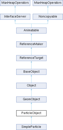

ParticleObject Class Referenceabstract
This is the base class for creating particle system plug-ins. More...
#include <C:/adskgit/3dsmax/3dsmax/3dswin/src/maxsdk/include/object.h>
Inheritance diagram for ParticleObject:
