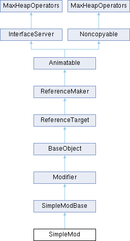

Inheritance diagram for SimpleMod:

Detailed Description
Base class for parameter block 1 (PB) based object space modifiers.
Description:
This class maintains a pointer to a parameter block. Derived classes that use a single parameter block don't need to overwrite methods for managing sub-anims and references since SimpleMod's implementation of the respective methods takes care of this.
This is a base class that is intended to be derived from, rather than be instantiated directly.
It manages the same references as class SimpleModBase, but adds a param block reference.
Typically, 3rd party modifiers that derive from class SimpleModBase would derive preferably from class SimpleMod2 in order to benefit from the features of ParameterBlock2 (see class IParamBlock2).
For more information see class SimpleModBase.
