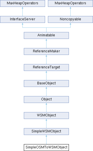

Inheritance diagram for SimpleOSMToWSMObject:

Detailed Description
See also
Class SimpleWSMObject, Class SimpleModBase, Class Deformer, Class IParamMap.
Description:
This class is used to allow any Object Space Modifier derived from SimpleModBase to easily be turned into a World Space Modifier (Space Warp).
This is very simple to do because a modifier version already contains just about everything that needs to be done. This is because the modifier works the same – it is just in world space instead of object space.
All a developer needs to do to turn their SimpleModBase modifier into the WSM version is implement a class derived from this one and call the SimpleOSMTOWSMObject constructor from their constructor. See the sample code below (for the full sample code using this class see /MAXSDK/SAMPLES/MODIFIERS/BEND.CPP).
class BendWSM : public SimpleOSMToWSMObject
BendWSM() {}
BendWSM(BendMod *m) : SimpleOSMToWSMObject(m) {}
void DeleteThis() { delete this; }
Class_ID ClassID() {return BENDWSM_CLASSID;}
