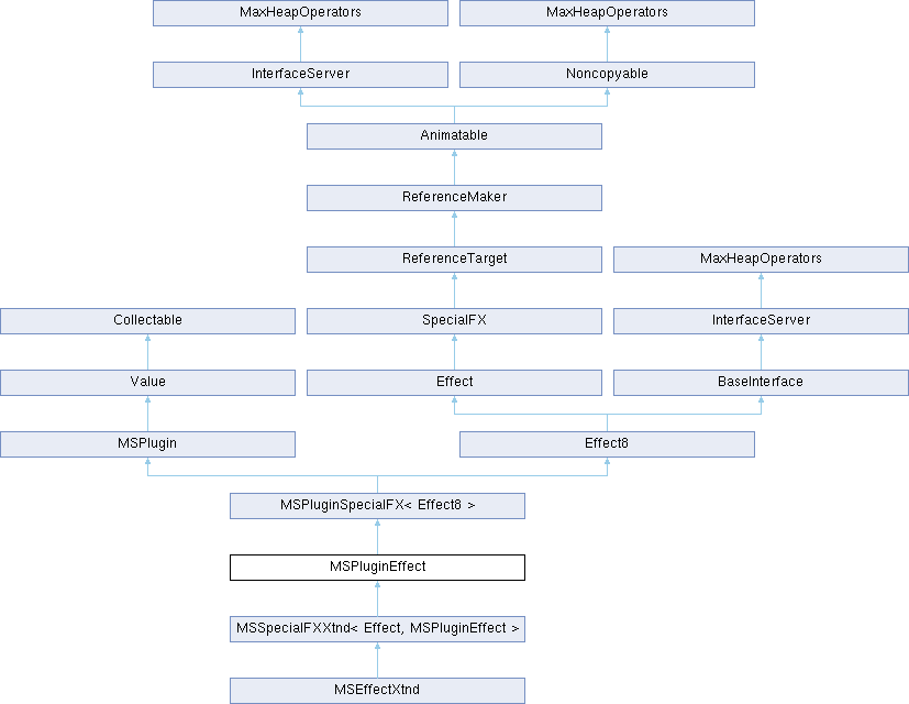

MSPluginEffect Class Reference
#include <C:/adskgit/3dsmax/3dsmax/3dswin/src/maxsdk/include/maxscript/mxsplugin/mxsPlugin.h>
Inheritance diagram for MSPluginEffect:
