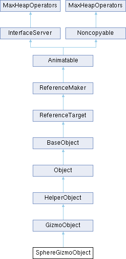

Inheritance diagram for SphereGizmoObject:
