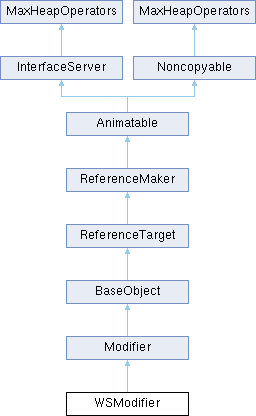

3ds Max C++ API Reference
This is a base class for creating world space modifiers. More...
#include <C:/adskgit/3dsmax/3dsmax/3dswin/src/maxsdk/include/object.h>
It simply provides a default implementation of SuperClassID(). World Space Modifier plug-ins use a Super Class ID of WSM_CLASS_ID.
