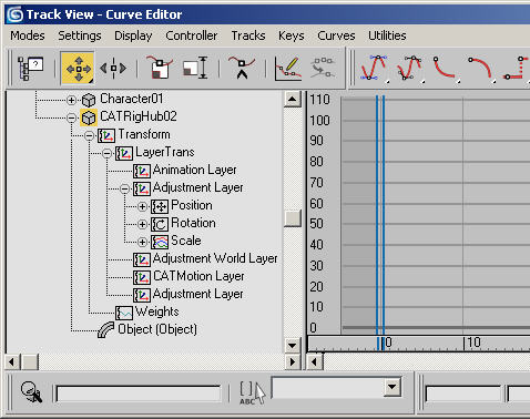

Active Layer
Only the active layer is visible in the 'Assign Controller' rollout tree view, or in Track View. The other layers are not displayed and instead a dummy controller is displayed.

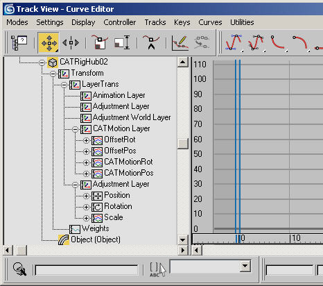

Contributing Layers
Only layers that are currently contributing to the pose and animation of the CATRig are displayed.

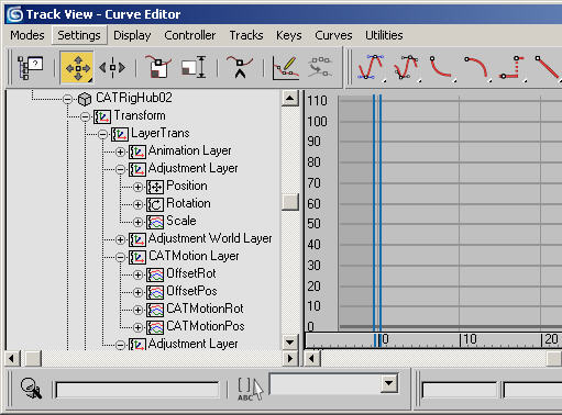

All Layers
All layers in the layer stack are displayed in full. All keyframes for all layers are displayed on the timeline, and you are able to do things like copy and paste controllers between layers in Track View.
