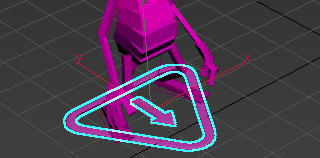

Here, for example, is Alien, one of the included CATRigs.
Before creating the Motion Extraction Node
The object under the alien, comprising a triangle and arrow, is its CATParent node.

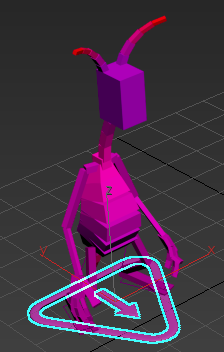

To create a motion-capture node:
Select the CATParent node.
- Go to the
Modify panel.
- Click Motion Extraction Node.
The arrow at the center of the CATParent appears to grow larger:
After creating the Motion Extraction Node
On top of the CATParent's arrow is a larger, separate arrow that represents the motion capture node.
The smaller CATparent Node (blue) and the CAT Motion Extraction Node (yellow)
Or, if you animate the motion extraction node so that alien moves in its world, you will see both the CATParent's arrow and the motion extraction node's arrow.
