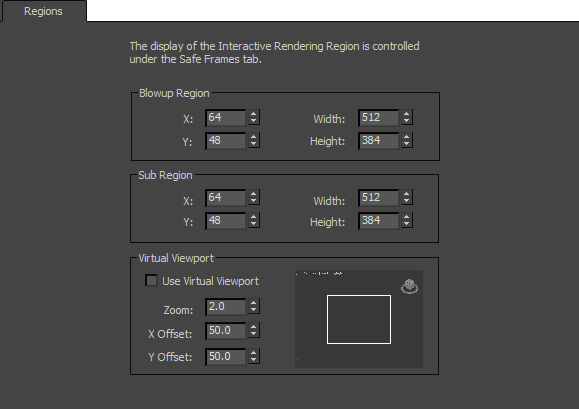

On the Regions panel of the Viewport Configuration dialog, you specify default selection rectangle sizes for the Blowup Region and Sub Region rendering options.
  • Click or right-click the General viewport label (“[ + ]”) . > General Viewport Label Menu > Configure > Viewport Configuration dialog > Regions tab
  • Default menu: Views menu > Viewport Configuration > Viewport Configuration dialog > Regions tab
  • Alt menu: Scene menu > Configure Views > Viewport Configuration > Viewport Configuration dialog > Regions tab
The rectangular selection region appears in the viewport when you choose either the Blowup or Region option from the Area To Render list. You can change the size of a region by dragging its handles, and its position by dragging anywhere within its borders.

  4. Click Use Virtual Viewport. A reduced image of the viewport displays in the dialog, along with a white zoom rectangle representing the virtual viewport.
  5. Use the Zoom, X Offset, and Y Offset spinners to adjust the size and position of the virtual window, or drag the white window anywhere within the image.

Blowup Region group
Sets the position and size of the blowup region. See Area to Render.
Sub Region group
Sets the position and size of the region to render. See Area to Render.
Virtual Viewport (OpenGL driver only)
OpenGL viewports have Virtual Viewport options that let you zoom in on a sub-region of the current viewport, creating a “virtual viewport” where you can perform any standard navigation, but in a zoomed-in area. For the Direct3D driver, these controls are disabled. When Nitrous is active, these controls don't appear at all.
You can use the virtual viewport on any type of viewport, but it's primarily designed for zooming in on camera views. This lets you perform close-up work, such as tracing, without distorting the relationship between the geometry and a bitmap background. (With the standard Nitrous viewports, 2D Pan Zoom Mode provides a similar function for camera, perspective, and spotlight viewports.)
Because you're actually zooming the viewport image itself, the viewport label might be hidden from display, but you can still right-click in the upper-left area of the viewport to display the menu. This takes advantage of zooming features in the OpenGL driver so that 3ds Max does not compute the display change internally.
Enables the virtual viewport. A reduced image of the viewport appears in the dialog, along with a white zoom rectangle representing the virtual viewport.
Adjusts the size and position of the virtual window. You can also drag the white window anywhere within the image.
