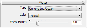

Interface
Type
Lets you choose the scale and texture of the water.
  • Swimming Pool (The default.)
  • Generic Reflecting Pool
  • Generic Stream/River
  • Generic Pond/Lake
  • Generic Sea/Ocean
Color
When the Type option is Generic Stream/River, Pond/Lake, or Sea/Ocean, this drop-down list lets you choose the color of the water.
  • Tropical (The default.)
  • Algae/Green
  • Murky/Brown
  • Generic Water/Lake
  • Generic Sea/Ocean
  • Custom When this option is active, a Custom Color color swatch appears. Click the color swatch to choose an arbitrary color for the water.
Wave Height
Sets the height of wave bumps on the water, in arbitrary units. Range: 0.0 to 5.0. Default=1.0.
This option does not appear for Generic Reflecting Pool
