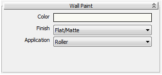

Wall Paint rollout
- Color
Lets you choose a color for the paint.
- Finish
Sets the glossiness of the surface finish of the paint.
- Flat/Matte (The default.)
- Eggshell
- Platinum
- Pearl
- Semigloss
- Gloss
- Application
Sets the texture of the paint, based on how the paint was applied.
- Roller (The default.)
- Brush
- Spray
