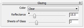

Interface
Glazing rollout
- Color
Lets you choose a color for the sheets of glass.
- Clear (The default.)
- Green
- Gray
- Blue
- Blue Green
- Bronze

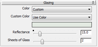

Custom
When Custom is active, the Custom Color drop-down list lets you set your own color.
- Use Color (The default.) Sets the color of the glazing.
Click the color swatch to change the color.
- Use Map Maps the color of the glazing.
Click the map button (or use Slate Material Editor node wiring) to assign a map to the material.
Color By Object Uses the object's
3ds Max wireframe color as the glazing color.
Important: When you use Color By Object, the color appears in renderings, but not in viewports or material previews. This is because the material might be applied to multiple objects that have different wireframe colors.
- Reflectance
Controls the reflectivity of the sheets of glass. Range: 0.0 to 50.0. Default=10.0.
- Sheets of glass
Sets the number of sheets of glass in a single object. The more sheets of glass, the greater the refractivity. Range: 1 to 6. Default=2.
