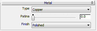

Metal rollout
Type
Sets the base color and texture of the material, and controls which properties are used.
  • Aluminum (The default.) For Aluminum, you can change the Finish.
  • Anodized Aluminum For Anodized Aluminum, you can change the Color.
  • Chrome For Chrome, you can change the Finish.
  • Copper For Copper, you can change the Patina and the Finish.
  • Brass For Brass, you can change the Finish.
  • Bronze For Bronze, you can change the Patina and the Finish.
  • Stainless Steel For Stainless Steel, you can change the Finish.
  • Zinc For Zinc, there are no further options.
Color (appears only for Anodized Aluminum)
Lets you set a custom color for Anodized Aluminum.
Patina (appears only for Copper and Bronze)
Lets you set a patina for Copper or Bronze. The higher the value, the more the amount of patina. Range: 0 to 1.0. Default=0.0.
Finish (does not appear for Anodized Aluminum or Zinc)
Lets you set a surface finish for Aluminum, Chrome, Copper, Brass, Bronze, or Stainless Steel.
  • Polished (The default.)
  • Semi-polished
  • Satin
  • Brushed

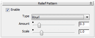

Relief Pattern rollout
Enable
When on, applies a relief pattern to the material. Default=off.
Type
Lets you choose a predefined relief pattern, or create a custom pattern.
  • Knurl (The default.)
  • Diamond Plate
  • Checker Plate

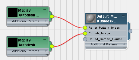

  • Custom - Image Lets you choose a bitmap to control the relief pattern.
Image (appears only for Custom - Image)
When Custom - Image is the active Type, click to specify a bitmap for the relief pattern.
Amount
Controls the height of the relief. Range: 0.0 to 2.0. Default=0.3.
Scale
Adjusts the scale of the relief pattern. Range: 0.0 to 5.0. Default=1.0.

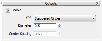

Cutouts rollout
Enable
When on, enables the use of Cutout maps for the material. Default=off
Type
Lets you choose a predefined cutout pattern or create a custom pattern.
For the cutout patterns that let you adjust dimensions, the values are set in inches.
  • Staggered Circles (The default.) For the Staggered Circles pattern, you can set a Diameter and a Center Spacing distance.
  • Straight Circles For the Straight Circles pattern, you can set a Diameter and a Center Spacing distance.
  • Squares For the Squares pattern, you can set a Size and a Center Spacing distance.

  • Custom For the Custom pattern, the Image button lets you choose a map to generate cutouts. The default map type is Autodesk Bitmap, but you can choose a different type using standard Material Editor methods.
