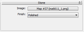

Stone rollout
- Image
Click to choose a bitmap that defines the surface appearance of the stone material.
- Finish
Sets the finish used for the stone surface.
- Polished (The default.)
- Glossy
- Matte
- Unfinished

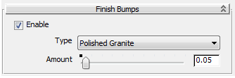

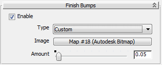

Finish Bumps rollout
- Enable
When on, the material uses a bump pattern for its finish. Default=off.
- Type
Lets you choose a preset pattern for the bump pattern, or choose a custom pattern.
- Polished Granite (The default.)
- Stone Wall
- Glossy Marble
Custom

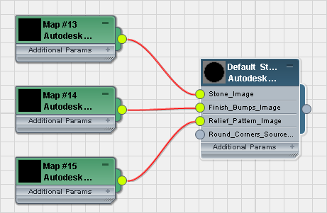

Click the Image button (or use Slate Material Editor node wiring) to assign a map to the material.
- Amount
Controls the height of the finish bumps. Range: 0.0 to 1.0. Default=0.05.

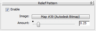

Relief Pattern rollout
- Enable
When on, applies a relief pattern to the material. Default=off.
- Image
Click to specify a bitmap for the relief pattern.
- Amount
Controls the height of the relief. Range: 0.0 to 2.0. Default=0.15.
