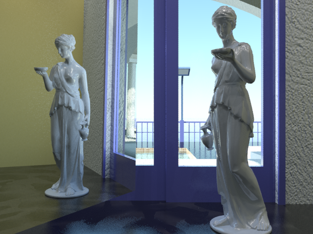

This material acts as a mirror.
Note: The material appears in the Material/Map Browser only if the active renderer supports it.
Mirror on the left reflects the room and the statue.
