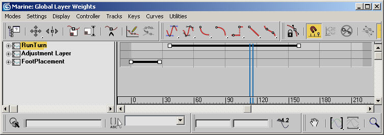

  1. On the Layer Manager rollout, click (Dope Sheet: Layer Ranges). The layers are displayed as individual tracks.
    Ranges View
  2. The ranges for the layers can then be squashed, stretched, and moved as usual in 3ds Max. They can also be reversed.

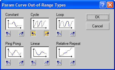

Setting Looping Options for a Layer
To access the looping options for this layer, click the Parameter Curve Out-of-Range Types' button.
You might have an animation on a layer that you would like to repeat in some way. This could be a simple action like a breathing motion on a ribcage, or a while walk cycle. You can use the ranges view to set the looping options for the entire layer.
Remember that each controller on the rig loops separately, so to get the whole layer to loop at the same time, you might want to set the layer time range manually (see following).

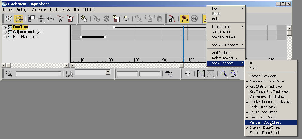

  1. In Dope Sheet mode, right-click the toolbar area of Track View.
  2. From the menu, choose Show Toolbars Ranges: Dope Sheet.
    3ds Max opens the Ranges toolbar.
