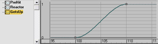

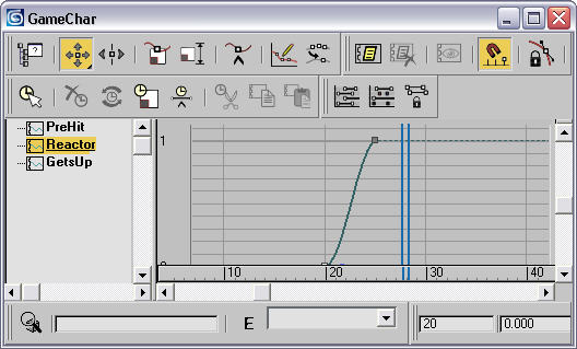

  3. On the Motion panel Layer Manager rollout, click (Curve Editor: Global Weights).
    The Curve Editor opens to the Global Layer Weights view, showing the existing layers for the rig. The following illustration shows three layers: PreHit, Reactor and GetsUp.
  4. Use (Insert Keys) to create a key at the frame to blend from and set the weight to 0.0.
  5. Insert another key at the frame to blend to and set the weight to 1.0.
    The layer will now blend on and the character will be controlled by the new layer.
