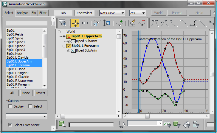

Displaying the Controller List
Click the Controllers button in the Workbench toolbar to display the Controller List. When the controller list is displayed you can select multiple tracks as you like, right-click them and assign controllers using the pop-up menu. You can also get to properties for controllers such as Noise that don't have keyframes.
Click the Controllers button in the Workbench toolbar to display the embedded curve editor's Controller window. The biped body tracks shown are in the list are the ones that are selected in the Select panel, in addition to any scene objects that are attached to those body parts or are used as IK objects for those body parts. The controller list is similar to the one in the curve editor.
Controller list displayed

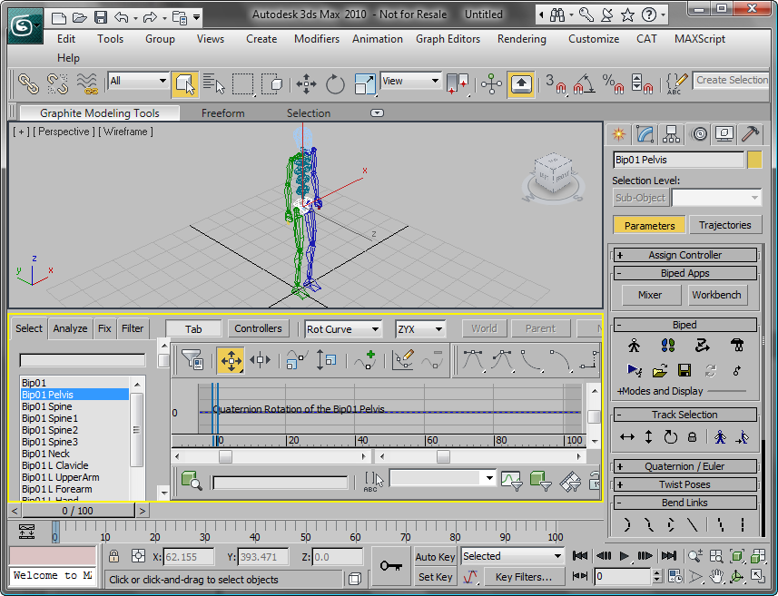

You can dock the Workbench in a viewport. With the Workbench open, click or right-click the Point-Of-View viewport label, then from the POV viewport label menu choose Extended Viewports
Biped AnimationWorkbench. The open workbench docks in the viewport.
