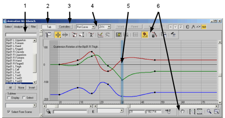

Interface
1. Tab panels (Select, Analyze, Fix, and Filter)
2. Display Tab panels
3. Display Controllers list
4. Workbench toolbar
5. Curve View
6. Curve View toolbars (same as Track View toolbars)
Animation Workbench Tab Panel
The Animation Workbench Tab panel consists of four panels:
  • Select panel Provides tools to select curves for biped body parts. For more information on the Select panel user interface, see Select Panel.
  • Analyze panel Evaluates the curves for error conditions. For more information on the Analyze panel user interface, see Analyze Panel.
  • Fix panel Provides a variety of methods to be applied to the errors located by the analysis. For more information on the Fix tab user interface, see Fix Panel.
  • Filters panel These are a special type of fixer that perform an operation over each key that is selected. When no keys are selected it performs the operation over the whole curve rather than using the results of the last error analysis. Use this when you have errors visible in the motion, but the fixer refuses to find them. For more information on the Filter panel user interface, see Filters Panel.
Use the Tab button on the Workbench toolbar to display and hide the Tab panel.
Curve View
To the right of the Tab area is the Curve View, where keys and curves for the selected biped parts are displayed. This is the same as the Track View Key window.
Curve View Toolbars
Directly above and below the Curve View are some of the standard 3ds Max Track View toolbars. They give access to tools used to navigate the view and manipulate the keys. The toolbars below the Curve View are used for selection and navigation; toolbars above the Curve View are used to move, slide, and scale keys; to scale values; and to add new keys.
Animation Workbench Toolbar
The Workbench toolbar extends the toolset found in the 3ds Max Track View. The Workbench toolbar includes:
  • Tab Hides or displays the Workbench Tab panel, which contains the tools for automated error analysis and correction fixers and filters.
  • Controllers Hides or displays a controller-window hierarchy list. This is the same list you see in standard Track View with the same right-click menus used to assign controllers.
  • Curve Type Determines which curves are displayed for the selected object.
    Rot Curve, Rot Speed, Rot Accel, and Rot Jerk curves represent rotation.
    Pos Curve, Pos Speed, Pos Accel and Pos Jerk curves represent position.
    Note: Choosing Rot Curve or Pos Curve turns on Show Biped Rotation Curves or Show Biped, Position Curves, respectively, in the Biped toolbar of the Curve Editor.
    Noise curves represent random position and rotation.
    Each biped part can show any of these curves, except for the Horizontal and Vertical tracks, which show only positional curves, and the Turning track, which shows only angular curves.
The Axis order drop-down lets you choose the order in which the rotation curves are calculated. The ordering follows the same rules as the Euler Axis Order on the Quaternion/Euler rollout.
When manipulating position curves, the Workbench allows the curves to be displayed relative to the World, the Biped Root, or any object in the scene as picked via the arrow button.
