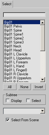

The Select panel of the Animation Workbench provides tools for selecting bipeds or biped components. You can manipulate the selected biped part's animation tracks via curves displayed in the Workbench, or by using the Analyze, Fix, and Filter panels to automatically identify errors and fix them.
The objects whose curves might be displayed are set using the selection drop-down list. To change the curves that are displayed go into the Controller window and select the curves you want to see
Once you’ve made a selection, you can hide the entire Tab area by clicking the Tab button on the Workbench toolbar. This gives you more room to work on the curves in Curve View.
The functionality of the Select panel is similar to the standard 3ds MaxSelection Floater.

Interface
- [selection field]
- Enter the name of the biped part you want to locate. That name (if found) will be highlighted in the Selection list. This is useful when you can't find an entry by scanning the list.
You can use the question mark and asterisk characters as wildcards, in order to select multiple objects at once.
- [selection list]
- The selection list displays all the body parts of all the bipeds in the scene.
You can use the Shift, Ctrl, and Alt keys to build selection sets, as in the rest of 3ds Max.
- All
- Selects every entry in the list.
- None
- Clears the selection so nothing is highlighted.
- Invert
- Selects everything not highlighted in the list.
Subtree group
- Display
- Indents the list to show the biped hierarchy. Default=off.
- Select
- When on, selecting one biped part selects both it and all of its children. Default=off.
- Named selection list
When you create a named selection in the scene, the named selection becomes available.
- Select From Scene
When Select From Scene is on, you can click the biped body parts directly in the viewport, rather than from the list. The curves are immediately displayed in the Workbench Curve View. This is handy if you don't know the name of the part you need to select.
