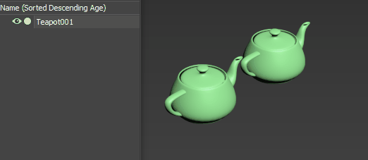

- In the following example, Teapot001 is an array object that contains two teapot clones. When
Create Object is clicked, two new objects named Teapot001_001 and Teapot001_002 are created and Teapot001 is hidden.
