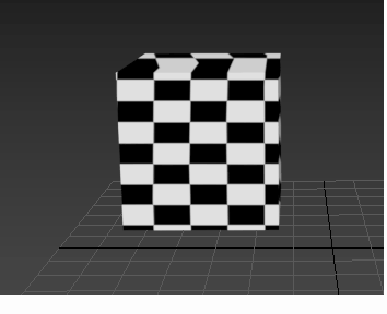

- Animated Camera
Allows the Camera Map modifier to work with animated cameras.
- When enabled (default), the UV map projection is updated on each frame from the new location of the camera.
Animated Camera parameter = turned on

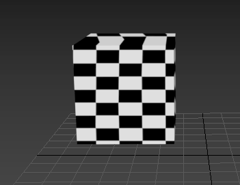

- When disabled, the UV map projection is not updated on each frame.
Animated Camera parameter = turned off
