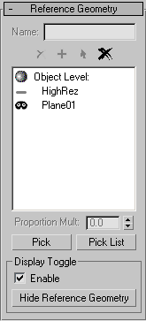

Reference geometry window
This window shows a list of named sub-object selection sets, and the high-resolution source geometry with which they're associated. If you have picked a high-res object at the object level, it also shows “Object Level” followed by the name of the source object.

Pick
To associate high-res geometry with the current selection, click Pick to turn it on, then click a source object in a viewport.
Pick List
To associate high-res geometry with the current selection, click Pick List, then use the Add Objects dialog, which works like the Select From Scene dialog, to choose a source object.

Enable
When on, makes it possible to show or hide reference geometries. Default=off.
Hide Reference Geometry/Hide Working Geometry
When Enabled is on, click Hide Reference Geometry to hide your hi-res geometry. Conversely, click Hide Working Geometry to hide your low-res geometry. You can also selectively show and hide high-res geometries in your Pick List. Click Off to hide a geometry. Click Hide to show a geometry.
