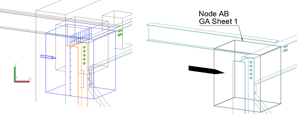

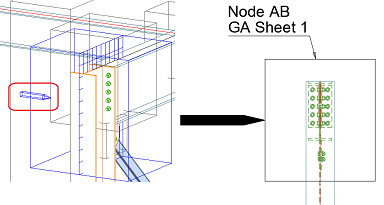

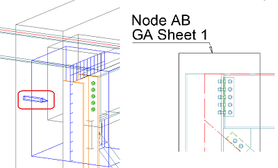

Important: The arrow is created only when the viewport of the general arrangement drawing is perpendicular on the model camera direction, or isometric to it. If the viewport is along the camera view direction, then the arrow symbol will not appear on the drawing.
  • Camera viewed from the side. The camera symbol arrow is visible:
  • Camera viewed along its direction. The camera symbol arrow is not visible:
  • Isometric view on the camera direction. The camera symbol is visible, and it is oriented in an isometric direction (not the 2D symbol as in the side view):
