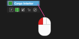

Use LMB on a layer or layer folder to display options for quickly picking objects and assigning them to layers as well as toggling symmetry on and off.

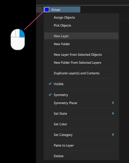

Use RMB on the layer number or layer name to access the full menu of layer options.

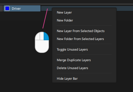

Use RMB on the empty space beside the layer name to access a condensed menu.
