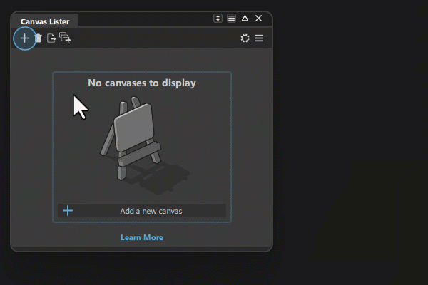

The Canvas Lister shows all of the canvases in a project. Use the lister to import and manage your canvases. Images can be imported as a canvas, which lets you place and transform them as planes.
This is useful for setting up reference images that need to exist in the scene. Canvases provide similar functionality as Image Planes do in previous versions of Alias.
Canvas Lister icon bar
- Add Canvas - Add a new canvas by importing an image.
- Delete Canvas - Delete the selected canvas.
Export All Canvases / - Export Selected Canvases - Export all or the currently selected canvases to the .jpg image format. Export Options can be customized in the Export Canvas Options.
