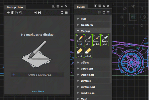

Markup Lister
Opens the Markup Lister, which lets you create, manage and export Markups in a project. Markups let you draw directly onto the camera view, making it easy to share feedback on design projects.
By default, the size of the Markup created is based on the width and height of the window. This can be changed in the General Preferences under Markup.
Selecting a Markup will automatically display it and make it active for drawing. In tile view, hover on a Markup's thumbnail to access the opacity slider and visibility toggle.
Markup Lister icon bar
Add Markup - Create a new markup based on the current view.
Delete Markup - Delete the selected markup(s).
Export Selected Markups / Export All Markups - Export either the currently selected or all markup(s). Export Options can be customized in the Export Markup Options.
Previous Markup - Display the previous markup.
Next Markup - Display the next markup.
Settings - Access the Settings menu:
  • Preview Size - Adjust preview size of markup thumbnails.
More menu - Access the More menu:
  • Add - Add a new canvas by importing an image.
  • Export - Exports all markups as .jpg images. Click the icon to access the Export Markup Options (also available in the context-menu).
  • Delete - Delete the selected markups (also available in the context-menu).
Markup Lister context menu

Markup workflows
Work with the Markup Brush
  1. Choose a brush from the Markup section in the Tool Palette.
  2. The first time you click on top of the current view will create a Markup based on that view. You can now begin drawing freely.
    Tip: When creating your Markup, turn on Predictive Stroke to improve the quality of your strokes by making them more uniform and smooth. It's especially useful when drawing straight lines, circles, or ellipses, and when drawing quickly using a mouse.
  3. To exit the current Markup and finish drawing on that Markup, rotate the view.
Work with the Markup Lister
  1. Open the Markup Lister in Canvas > Markup Lister. Position the view to the area you want to annotate.
  2. Click the "+" icon. This will create a Markup based on the current view. You can now beging drawing freely.
  4. You can see the current active Markup and access all Markups and the Markup Lister from the viewport window pane header in the top right corner.
Tip: Zooming and panning will still keep you within the active Markup, allowing you to work on details. Only rotating will exit the active Markup.

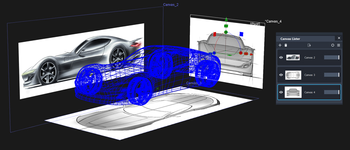

Images as Canvas
Images can be imported as a canvas which lets you place and transform them as planes. This is useful for setting up reference images that need to exist in the scene.
Import through file menu
  1. Select File > Import > Canvas
  2. Choose an image using the file browser.
  3. The image is placed facing the camera and can now be transformed.
Import through Canvas Lister
  1. Open the Canvas Lister in Canvas > Canvas Lister.
  2. Click the "+" icon to open the file browser and choose an image.
