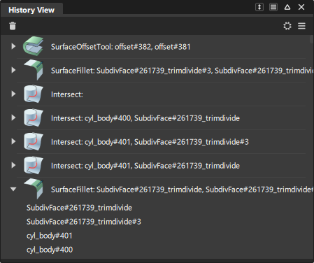

History View
Opens the History View window. Use History View to view and edit the construction history of the picked objects. The window shows operations you have performed that are maintaining construction history.

History View icon bar
- Delete Selected - Deletes the selected construction history. This does not delete the actual objects, only the construction history being maintained. It is the same as picking the object and choosing Delete > Delete Construction History.
- Setting - Access the Setting menu:
  • All - Show all objects with history.
  • Active - Show only the picked objects with history.
  • Affecting Active - Show the objects contributing to the history of the picked objects.
  • Affected by Active - Show the objects which were created from the picked objects.
  • Sorted by Type - Group operations together on the list by the tool used.
- More - Access the More menu.

History View workflows
Sort the objects by the tool used to create them
  • To group objects created by the same tool together, open the history window’s List menu and choose Sort By Type.
  • To list objects normally (roughly in the order you created them), turn off Sort By Type.
View how an object was created
  1. In the History View window’s List menu, choose Active.
  2. Pick the object.
  3. Click the arrow next to the name of the object.
    The list shows the operation’s constructors and target (result).
    Tip: Press and hold the on the name of an object in the History View window to highlight the object in the modeling windows.
Change the tool options used to create an object
  • In the History View window, click the icon next to the name of the object.
Edit tool option history by clicking an object
  1. Choose Query Edit.
  2. Click the object, either in the view or in the Object Lister (Windows > Object Lister).
    If the object has editable history, the Query edit tool will automatically select the appropriate tool for editing.
Delete construction history
Breaks the links between the picked object and any objects that you used to create it.
  1. Pick the object from which you want to delete construction history.
  2. Click the .
Suspend and resume construction history updates
  • To suspend history updates, open the Rebuild menu and choose Global Suspend.
    Suspended construction history is indicated by this icon: .
  • To resume history updates choose Resume.
