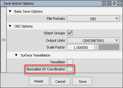

Importing/Exporting improvements
  • We added a Normalize UV Coordinates option to Export OBJ to support working with Rendering software.
