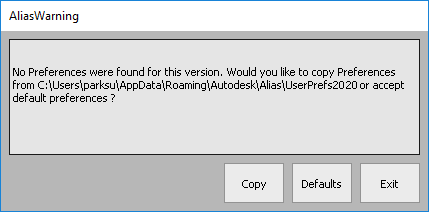

If you are using existing user preferences from an older version of Alias, you may not notice when the default values of options change.
User preferences for Windows are located in C:\Users<username>\AppData\Roaming\Autodesk\Alias\UserPrefs2019.
User preferences for Mac OS are located in /Users//Library/Preferences/Autodesk/Alias/UserPrefs2019.
If the folder does not exist, it is created the first time Alias 2020 launches. The following dialog appears:
Choose Defaults to accept the new default preferences.

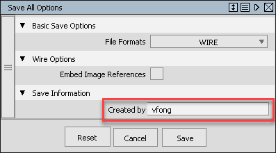

New Created By option for files
When saving or exporting a file, you can now save the author information (Created By) in the Save All Options dialog under Save Information (File > Save As and File > Export > Active As ).

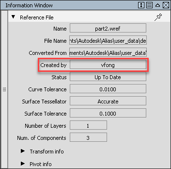

The author information is stored with reference files created from the saved .wire file. Created By displays in the Information Window when you view the selected .wref geometry.

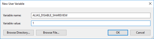

Disable Share View
You can now disable the Share View command (File > Share View) by setting the environment variable ALIAS_DISABLE_SHAREVIEW to 1.

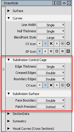

New Draw Style options
To support the new Subdivision features, we added Draw Style options for the subdivision surface geometry and control cage manipulator.
