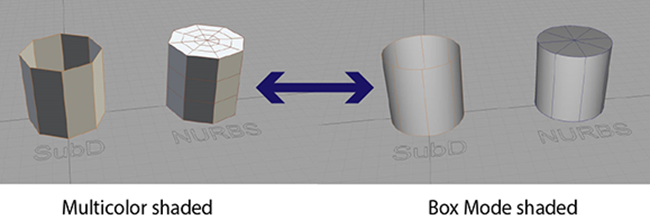

New Box Mode diagnostic shader
The Box Mode diagnostic shader
displays the Subdivision and NURBS geometry in a simplified poly form. Click Shading Off to turn off Box Mode shading. This shader is useful for detecting surface quality problems such as odd-sized faces, edge loops that zig-zag, or other surface irregularities.
