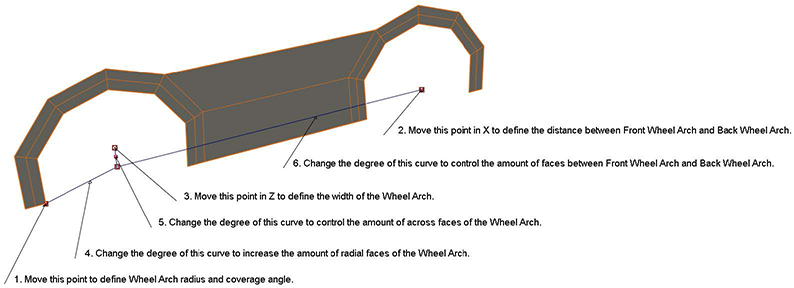

New Dynamo sample file
We added a new Dynamo script example and accompanying .wire file to the Dynamo Sample Files. The new sample files are located in the Subdiv Wheel Arch folder, which is included in the Alias installation directory. For example: C:\Program Files\Autodesk\AliasAutoStudio2021\Dynamo\Sample Files.
The Subdiv Wheel Arch sample file helps you quickly create wheel arches using Dynamo.
Note: There is a short delay the first time you modify the Alias geometry driving the Dynamo script. This delays occurs while the Dynamo libraries are loading. Subsequent modifications happen much faster.

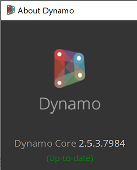

Updated version of Alias-Dynamo
Alias-Dynamo has been updated to Dynamo version 2.5. For information about new features, enhancements, and fixes, see the Dynamo Release Notes.

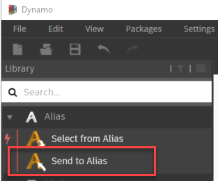

Renamed Bake to Alias
We've renamed the Bake to Alias command and node to Send to Alias.
