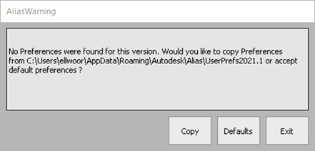

General disclaimer
If you are using existing user preferences from an older version of Alias, you may not notice when the default values of options change.
User preferences for Windows are located in C:\Users\username\AppData\Roaming\Autodesk\Alias\UserPrefs2022.
If the folder does not exist, it is created the first time Alias 2022 launches. The following dialog appears:
Choose Defaults to accept the new default preferences.
