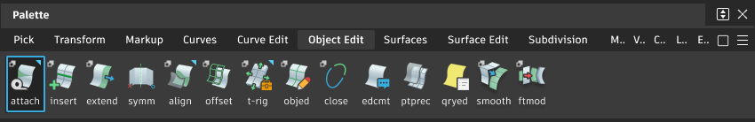

Access this tool from the Object Edit tool palette:

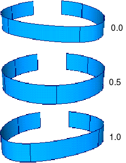

Blend Bias
(Only the Blend type uses this option.).
The percentage preference (weighting), from 0 (first object only) to 1 (second object only), between the two original objects when blending.
A value of 0 moves the end of the first object to the end of the second object.
A value of 0.5 modifies both objects equally so their ends meet halfway.
A value of 1 moves the end of the second object to the end of the first object.

In the Object Edit palette, select the Attach > Attach tool

In the Object Edit tool palette, select the Attach > Attach tool
