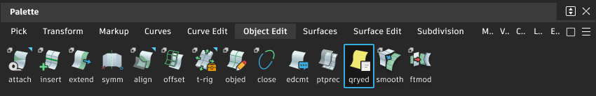

Click an object to open the options for its construction history, or RMB-select an object to show information about its geometry and highlight construction history dependencies.
Access this tool from the Object Edit tool palette:
