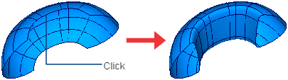

Converts an open curve or surface to closed, or a closed curve or surface to open. Open objects have free endpoints or edges, and closed objects have connected endpoints/edges.
When a curve is closed, it forms a continuous loop, with no loose ends. When a curve is open it has two ends that can be moved independently, though they might happen to occupy the same point in space.
Similarly, a surface can be closed (periodic) across U, V, or both dimensions. When a surface is open, it has free edges.

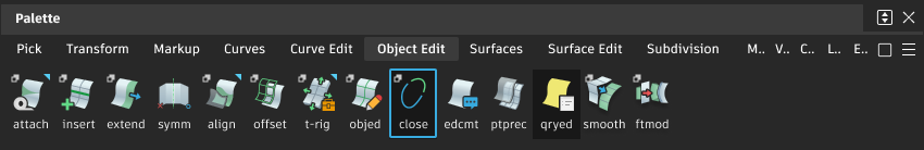

Access this tool from the Object Edit tool palette:

  1. Select the Close tool.
  2. Click the curve.
Open or close a surface
  2. Click a U or V isoparametric curve or edge to open or close the surface across that dimension.
