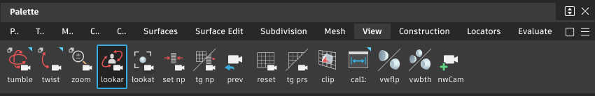

Look Around
Constrains the position of the camera when focusing and zooming on a point of interest.
Access this tool from the View palette:
Look Around workflow
