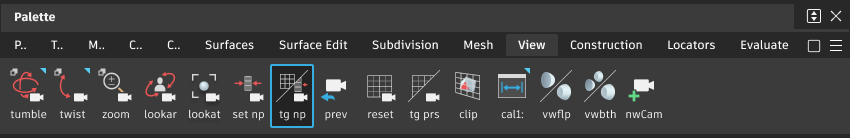

Access this tool from the View palette:
Toggle Non Proportional View workflow
