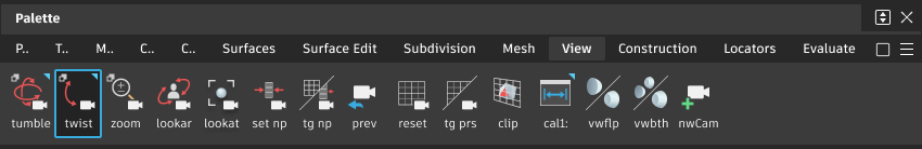

Access this tool from the View palette:
To tilt the drag with the mouse, or type the twist angle and press Enter.
