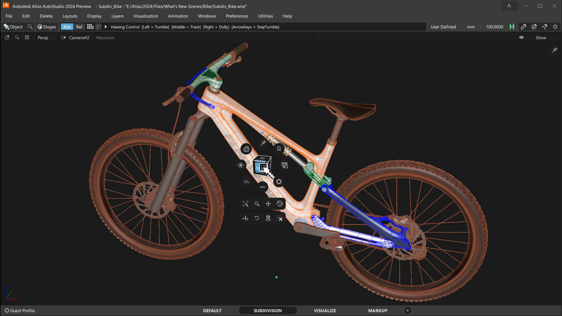

  • In Alias 2024 we've added a newly designed NavBar and updated the ViewCube.
  • The first thing you'll notice is that the NavBar tools now display by default along with the ViewCube.
  • You no longer need to press Shift plus Alt to access them.
  • Mousing over the dimmed ViewCube also displays tool hints for the mouse interactions used when tumbling, panning, and zooming the view.
  • Note that these tools have been recalibrated to improve control.
  • You now have two choices for organizing the NarBar tools.
  • There is now a Radial Layout which arranges the NarBar tools around the ViewCube in a ring and Vertical Layout which arranges the two vertically beneath ViewCube.
  • In the radio layout, the two navigation tool sections can be displayed or hidden using the plus and minus icons.
  • In Vertical Layout, the two navigation sections can be collapsed by clicking the horizontal line between the sections.
  • Switch between these layouts by selecting the more settings icon and then toggling Radial Layout on or off.
  • Radial Layout is on by default.
  • Notice the Options menu here where you'll find other options for displaying the ViewCube.
  • When in Radial Layout, you could unpin the ViewCube and NavBar from its location at the top right corner of the Viewport.
  • After unpinning, the ViewCube in tools follow your cursor as you move it in the viewport.
  • Press Shift + Alt to display the ViewCube at your cursor's position.
  • Click the pin icon to return the ViewCube to the top right of the viewport.
  • Note that you can now assign hotkeys to each ViewCube view.
  • In the Hotkey Editor, look under Special, then ViewCube functions.
  • We've also made some updates to the NavBar tools.
  • For example, you'll now find the Turntable tool on the NavBar.
  • The Look At tool is also now accessible on the tool bar.
  • An updated Non Proportional Scale button now lets you scale views non proportionally as well as toggle back to the normal view.
  • Click and drag to scale the view.
  • Then click the button to toggle between the non proportional view and normal view.

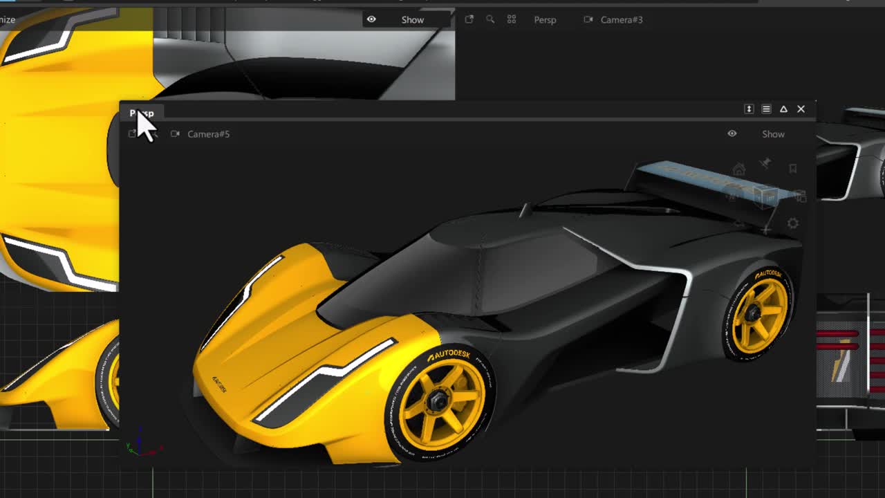

  • Use the Clone View tool to create a floating copy of an active window.
  • The clone is a 1 to 1 copy of the source window.
  • Initially, the viewpoint is the same as the source camera.
  • But, if you create a new camera, it can be tumbled, zoomed, and panned independently.
  • The clone window can be moved outside the Alias window and onto a second monitor making this useful for collaboration and presentations.
