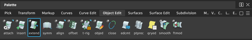

Access this tool from the Object Edit tool palette:
Extend Object Options

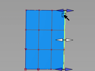

  2. Click near the endpoint of a curve, curve on surface, or an edge of a surface.
    A double arrowhead manipulator (for curves) or thick green border with three double arrowhead manipulators (for surfaces) indicates which end or edge will be extended.

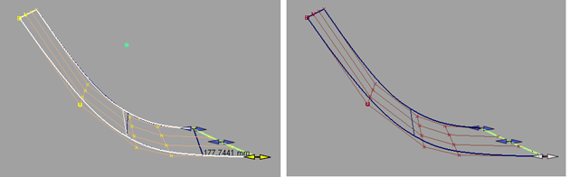

  3. Do one of the following:

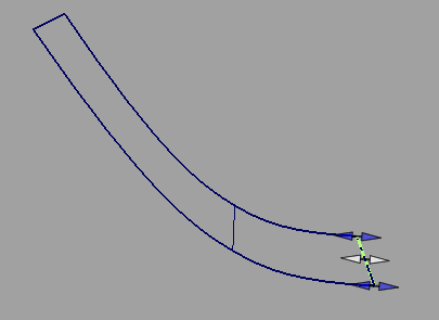

    • For a curve, drag the mouse to change the extend length.
    • For a surface, select the middle manipulator and drag to extend the surface proportionally. Or select one of the outer manipulators and drag to extend the surface non-proportionally.
    • Instead of dragging, you can type a distance and press 'Enter'. The distance is measured either in the current linear units, or as a percentage, depending on the Measurement setting in the Extend Object Options window.

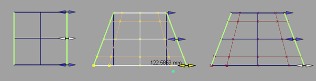

    If using the Extrapolate type with Merge on, you can select two opposite edges of a surface and symmetrically extend both at the same time, as shown below.
    In all other cases, you can only use non-proportional Extend when a single edge is selected. Consequently it will not work when Chain Select is on and several tangent continuous edges are selected automatically.
