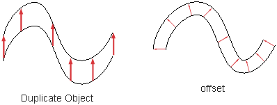

Creates an object offset a specific distance from an original. Every point on the copy is a specific distance from the corresponding point on the original.

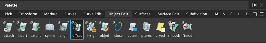

Access this tool from the Object Edit tool palette:

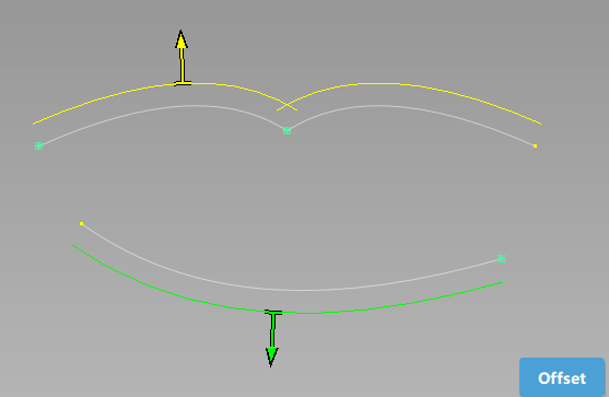

Offset several curves in the same direction simultaneously
  1. Pick one or more curve(s) or curve(s)-on-surface.
  2. Select the Offset tool .
    Curve sets are created based on topology. Each set shows an offset preview of a different color with an arrow indicating the unified direction of the offset.
    Note: The Topology Distance (in Preferences > Construction Options) is used to determine which curves form a unified set that must be offset in a single direction.
  3. Do any of the following:
    • Click on an arrow to modify the offset direction for a set.
    • Drag the left and right to change the offset distance.
    • In the Offset Control window, type a number to set the offset distance exactly and specify other options for the offset.
    • Select additional curves (or de-select them) by holding the Shift key while clicking them or using a pick box.
  4. Click the Offset button.

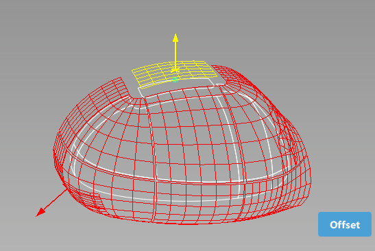

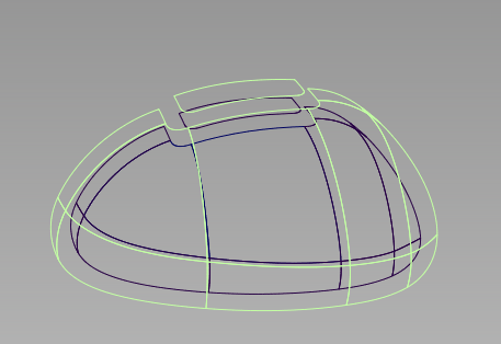

Offset several surfaces in the same direction simultaneously
  1. Pick the surfaces you want to offset.
    Surface sets are created based on topology. Each set shows an offset preview of a different color with an arrow indicating the unified direction of the offset.
    Note: The Topology Distance (in Preferences > Construction Options) is used to determine which surfaces form a unified set that must be offset in a single direction.
  3. Optionally do one of the following:
    • Select additional surfaces (or de-select them) by holding the Shift key while clicking them or using a pick box.
    The offset preview updates.
    The offset surfaces are created and grouped.
