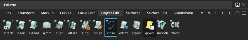

Access this tool from the Object Edit tool palette:

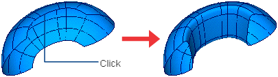

Open or close a surface
Select the Close tool.
Click a U or V isoparametric curve or edge to open or close the surface across that dimension.
