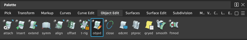

Object Editor
Allows you to reshape curves and surfaces by dragging handles attached to the object.
Access this tool from the Object Edit tool palette:
