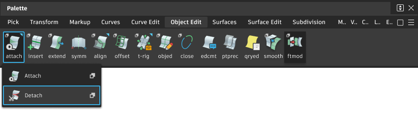

Separates a curve or surface into two or more objects at any point.
Access this tool from the Object Edit tool palette:
