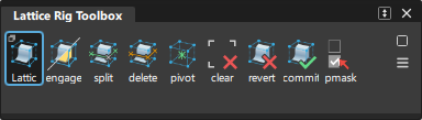

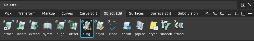

Access the Transform Rig from the Object Edit tool palette:

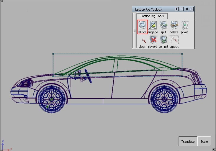

Lattice Rig toolbox
Selecting the Lattice Rig icon opens the toolbox:
Lattice Rig option window
To open the option window, double-click or Shift-click the icon.

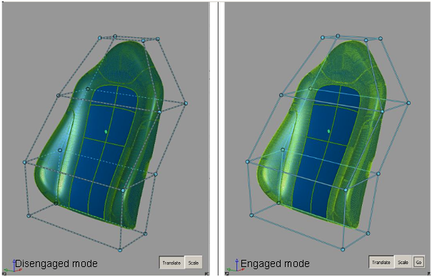

Toggle lattice engage state
When the lattice is in disengaged mode, its lines are drawn as dashed lines, and changing the lattice does not change the target geometry. To engage the lattice, click the tool; to disengage, click the tool again. The tool works as a toggle between the two modes.
Split lattice edge
The split tool adds new lattice segments like a belt wrapped around the lattice box. The split tool is only accessible while in disengaged mode. To split an edge of the lattice, click this tool, and then click the edge that you want to split. The split is perpendicular to the edge you have selected.
To split the lattice right in the middle between two lattice points, press Ctrl while dragging the new split along the lattice. To confirm the location of the split, click Accept Split. When you have finished splitting the box, click the DONE button.
Delete lattice edge
This tool deletes the “belts” from the lattice box that were inserted.
Center lattice pivot
This tool allows you to center the lattice pivot. This pivot is the point about which the lattice points are scaled.
Lattice clear selection
This tool clears the selection for the lattice points.
Revert
When targets are added to the rig, they are duplicated. The shape modifications are performed with these duplicated geometry. To restore the original geometry and to delete the modified geometry and history, click Revert. Notice that the manipulated modifiers do not return to their status before the dynamic modeling.
Commit
Click Commit to confirm the dynamic shape modification and delete the original geometry and the history.
Show Pick Mask
This tool helps when selecting targets for use in the rig. It is only usable when you first enter the Lattice Rig.

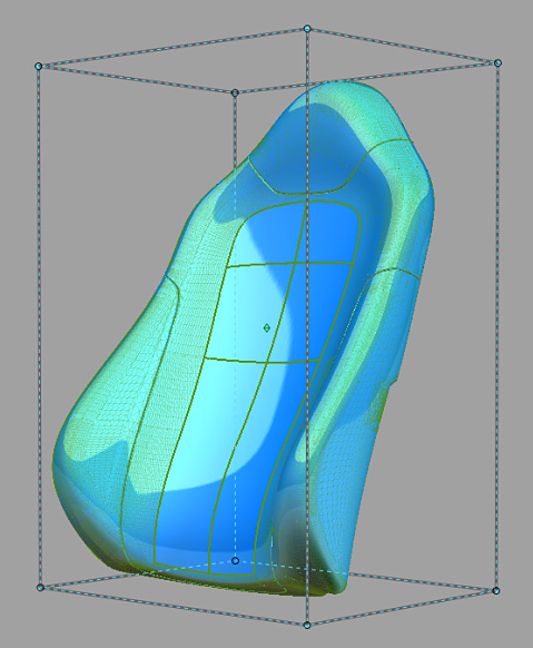

Set up a Lattice Rig
  1. Pick the surfaces that you want to modify.
  2. Click the Lattice Rig icon to open the Lattice Rig toolbox.

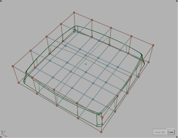

    The toolbox of the Lattice Rig appears, and an initial lattice box is placed around the selected geometry. The lattice starts off being a simple box slightly larger than the target geometry.
    Notice that the edges of the lattice are shown with dashed lines. This shows that it is "disengaged", and changes made to the lattice do not affect the target geometry.

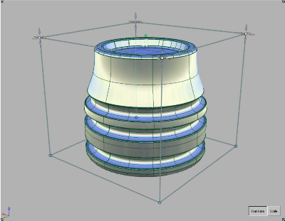

  3. To add detail to the lattice, choose the Split Lattice Edge tool. Place the cursor over an edge, and click a mouse button. A set of green lines appears, which can be repositioned until you select either Accept Split or Cancel. If you are satisfied with the placement of the new edges, click Accept Split.
  4. Repeat until there are sufficient number of points to best approximate the shape of the target geometry. Click Done when you are satisfied with the number of points.

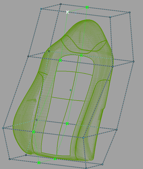

    Next, start to move the points so the lattice better approximates the shape of the geometry.
    You have a choice between translating (moving) or scaling the points.

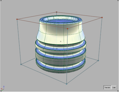

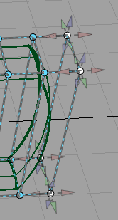

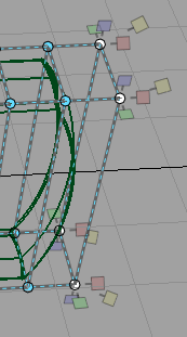

  5. Click-drag a box around a group of points to select them, or pick the points one at a time.
    Points turn white when selected. Click Translate to enable the translate manipulators.
    Notice the cones pointing out from the active points. These manipulators show the directions in which you can pull the points.
  6. Pull manipulators and reselect points to shape the lattice to the geometry.

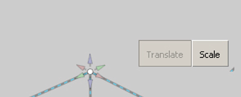

  7. To scale points, click Scale. The manipulators change to the following:
  8. Pull manipulators and select points to scale the lattice.
  9. When you’re finished shaping the lattice, choose Toggle Lattice Engage State.
    Notice that the lattice is now drawn with a solid color, and the target geometry is drawn in yellow-green. This indicates that the lattice is engaged, and further modifications to the lattice will change the target geometry.

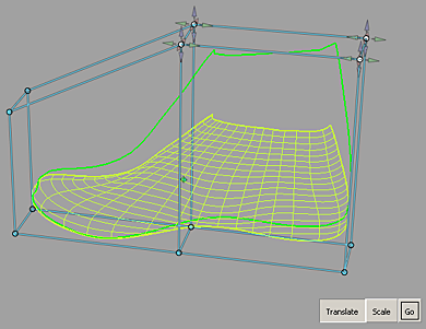

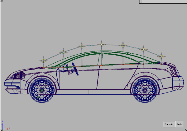

  1. With the lattice engaged, pick a lattice point.
  2. Click Translate, and move the lattice point.
    Notice that the target geometry updates to reflect the change. If Auto Update is turned on, a lightweight proxy of the model is used for display purposes while the mouse button is held down, and the model updates when you release the mouse button. If Auto Update is OFF, the proxy is used until the Go button is clicked.
  3. If you want to move a number of points, pick them, then move the picked points by using the manipulators on one of the points: the other points will follow.
    • If you want to scale a point, click Scale, and pick and move the point.
    • If you want to scale a number of points, pick them, then scale the picked points by using the manipulators on one of the points: the other points will follow. Note the location of the scale pivot. You can move it to an appropriate spot to affect the scaling operation.
  4. Repeat the same workflow for the rest of the lattice points to reshape the geometry.

  1. Open the Lattice Rig toolbox by selecting the Lattice Rig Toolbox icon . The Lattice Rig Tools window opens.
  2. Select the target geometry, then click Accept Targets.
  3. A basic lattice box appears around the geometry in disengaged mode.

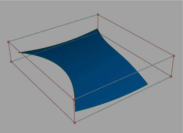

  • When the Lattice Rig is applied to this surface, the two sides of the lattice are locked, with no obvious reasons.
    If you turn on the CVs of the surface, you see that the surface is a trimmed surface, and the removed parts intersect with the lattice.
    Shrinking the trim will fix this problem.

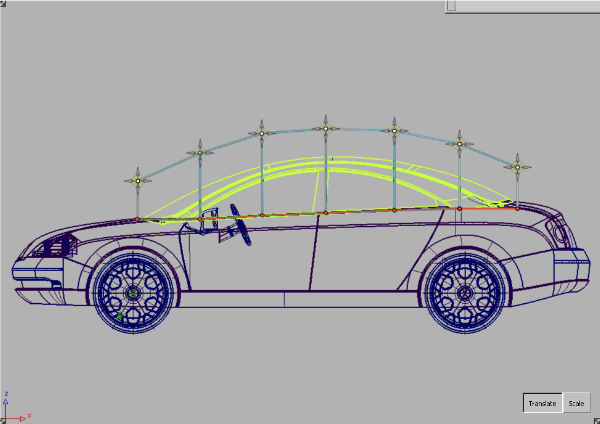

  • The Lattice rig may be too close to the surface. In these cases, move or scale the lattice away from the target geometry. In this example, the initial lattice is too close to the top of the target.
    Translating the top of the lattice upwards solves the problem.

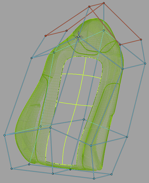

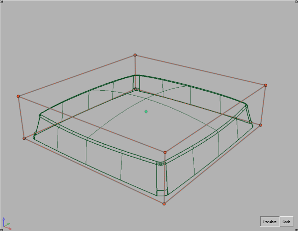

  • The Lattice Rig should be adapted to fit the geometry shape as best as possible. The closer the rig is to the shape of the geometry, the more controlled the results will be when the target geometry is modified.
    In this example, the initial lattice is based on the bounding box of the target surfaces. It does not match the shape of the target surfaces well, and is not going to be an effective lattice when deforming the greenhouse of this car.
    In these next two illustrations, the lattice has been refined to follow the shape of the target surfaces better.

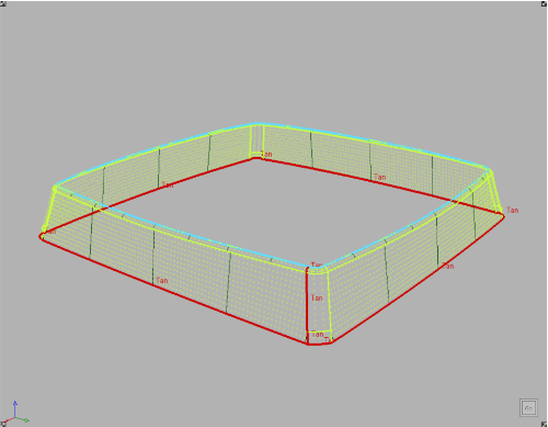

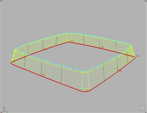

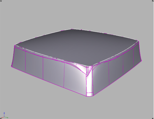

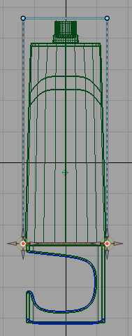

  • It is important that a modifier and a constraint do not cross or touch.
    Otherwise, you are simultaneously telling the rig that a certain region must both move and remain stationary. The result is that points that were originally close will be pulled apart in unpredictable ways. In the following example, this can lead to crumpling or denting effects.

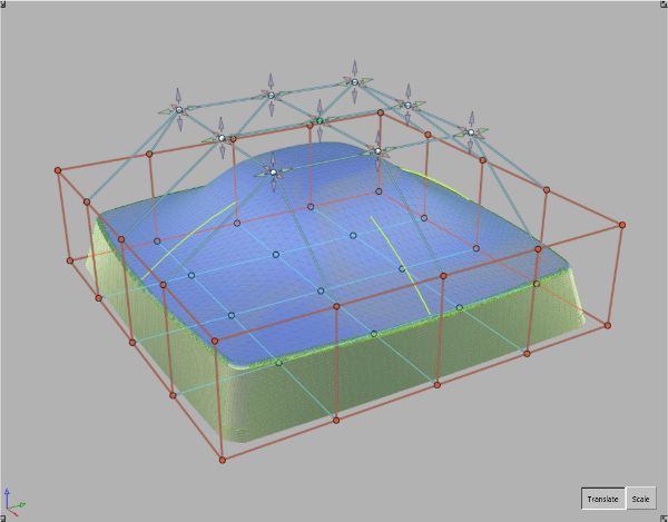

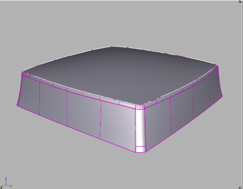

    In this example, we want to stretch this box upwards. We define the top surface as the modifier, and the bottom curves as the constraints. The modifier and the constraints do not touch or interfere with each other.
    Therefore, the shape modification is successful, as shown here.

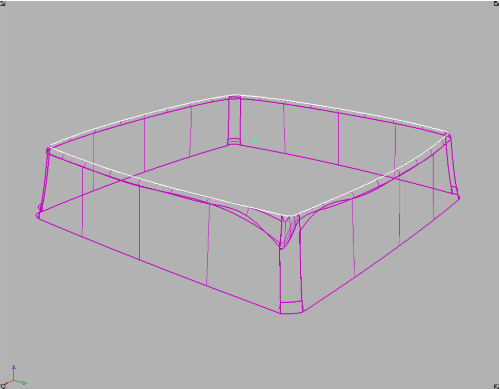

    Below is the wireframe to show the resulting surface structure.

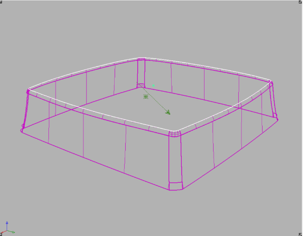

    Next, we added a new vertical constraint, and this new constraint touches the modifier.
    If we now drag the modifier upwards, it causes a conflict at the point where the constraint and the modifier touch, and will result in a warp of poor quality, shown below.

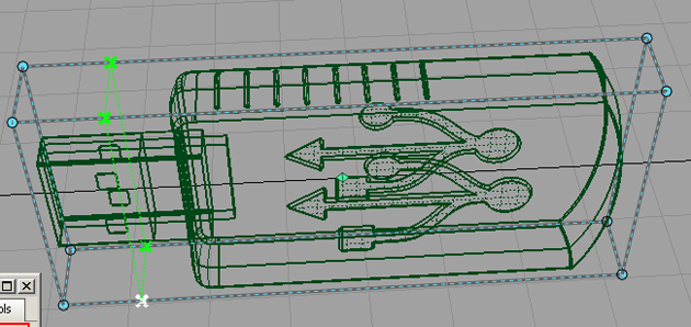

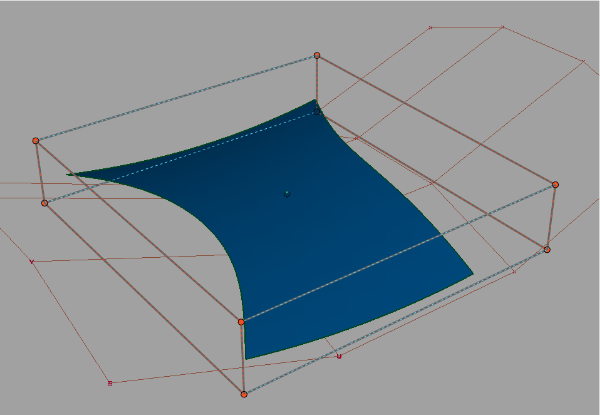

The lattice is a manipulator in the Lattice Rig tool. It is initialized as a bounding box around the target geometry.
The lattice has two modes: disengaged and engaged. A disengaged lattice is drawn with dashed lines, and when modified, has no influence on the target geometry. This gives you the ability to refine the lattice to suit the intended modifications of the target geometry.
An engaged lattice is drawn with solid lines, and when manipulated, modifies the target’s geometry.
About_composite_graphics0021
Constraining the lattice

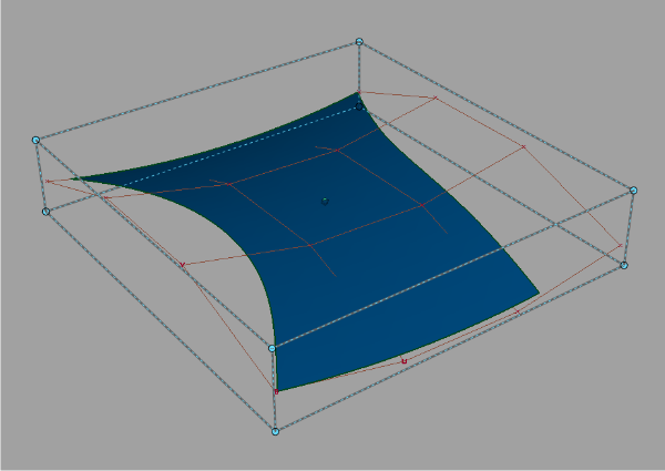

You can shape the disengaged lattice so that it does not fully enclose the targets.
When the lattice is engaged, everything that is outside the lattice remains unchanged; everything that is inside the lattice is modified.
To facilitate this, parts of the lattice that intersect the targets are locked and drawn in red.

What happens with the target geometry?
As soon as the targets are picked and accepted, the tools duplicate the targets. Shape modifications happen on the duplicated model. The original geometry is made invisible.
While you are modifying the shape of the geometry, the dynamic shape modeling tools allow you to toggle the visibility of the originals and the modified geometry. This makes it easier to compare your modifications with the original.
If, for any reason, the duplicated geometry (visible geometry with dynamic shape history) is modified in such a way that the construction history has to be deleted, the original geometry is set visible and made into a template.
RiggedWatch
The tools allow you to revert a modification by deleting the duplicated geometry and restoring the original, or commit to a modification by deleting the original and the history.
