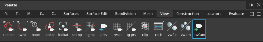

Creates a new camera in the scene. A new copy of the camera is made, which can be modified independently of the original camera.
Access this tool from the View palette:
