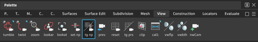

Toggle Non Proportional View
Toggles the view of the current window between proportional and non-proportional scaling. This only has an effect if you have first non-proportionally scaled the view.
No other aspects of the camera view are changed when using this tool.
Access this tool from the View palette:
Toggle Non Proportional View workflow
Once you have created a non-proportional view with the Set Non Proportional View , you can use Toggle Non Proportional View to switch back and forth between your non-proportional and proportional view. No other aspects of the camera view are changed when using this tool.
