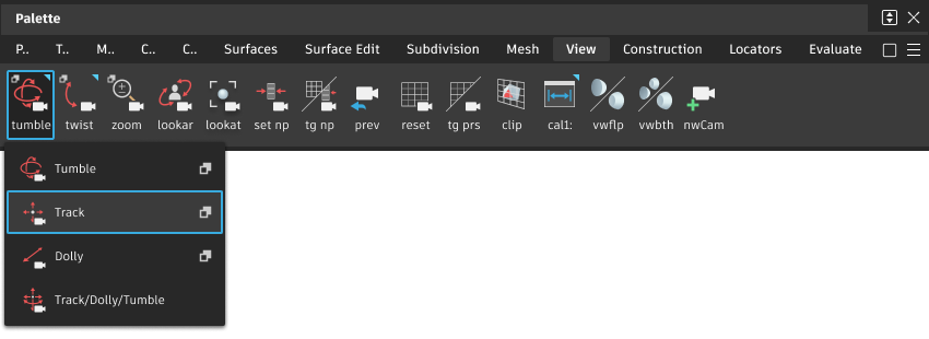

Track
Slides the view horizontally or vertically. This tool lets you set certain options more precisely than the View Panel or ViewCube.
Access this tool from the View palette:
